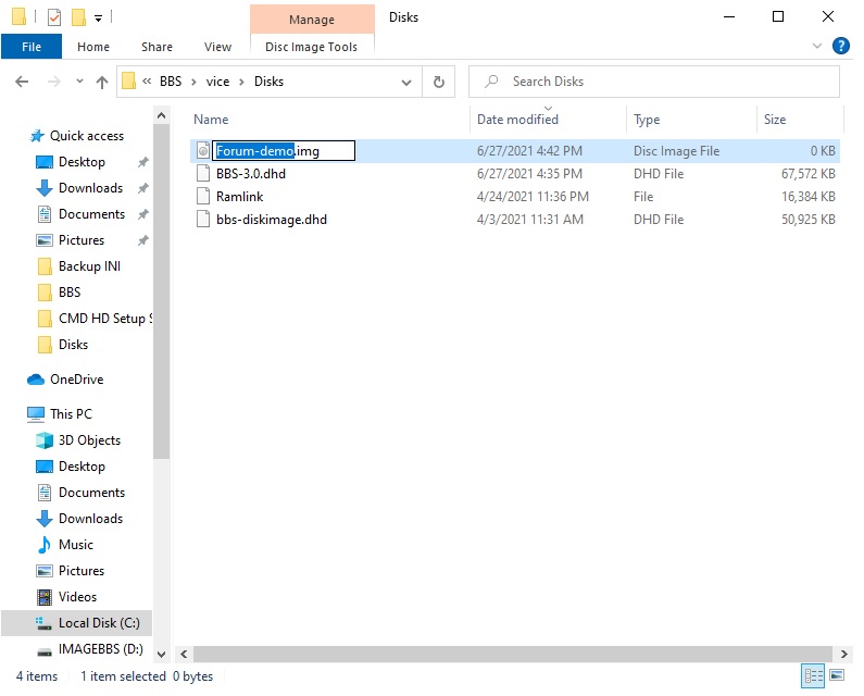

We must create an empty text file that will become the RAMCard image file.
In File Explorer, browse to where you want to keep your RAMCard Image. I use VICE/Disks
Right click and select New > Text Document.
Name the new document filename.ram
RAMCard Filename.jpg (76.75 KiB) Viewed 44165 times

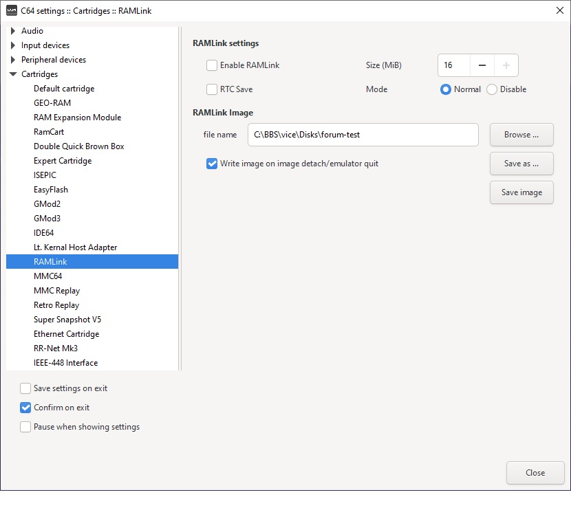

Once loaded go to Preferences > Settings > Cartridges > RAMLink.
RAMLink Settings.jpg (85.65 KiB) Viewed 44165 times
Click the check box next to Enable RAMLink, select the Size in MB of the RAMCard you wish to emulate (There is no reason not to select the max 16MB..).
Click the Radio Button next to Normal under the mode settings.

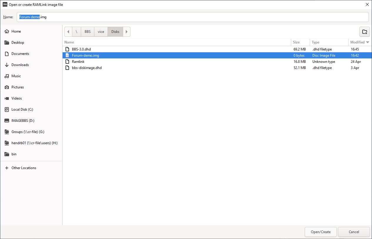

Next we must select the Image file to use (This is where the contents of the RAMCard will be saved, this is NOT your RAMLink.bin file.).
Select RAMCard Image.jpg (95.9 KiB) Viewed 44165 times
Click the Browse Button
Browse to the location of the file you created earlier. VICE/Disks/<filename.ram>
Select the file, and click Open/Create.

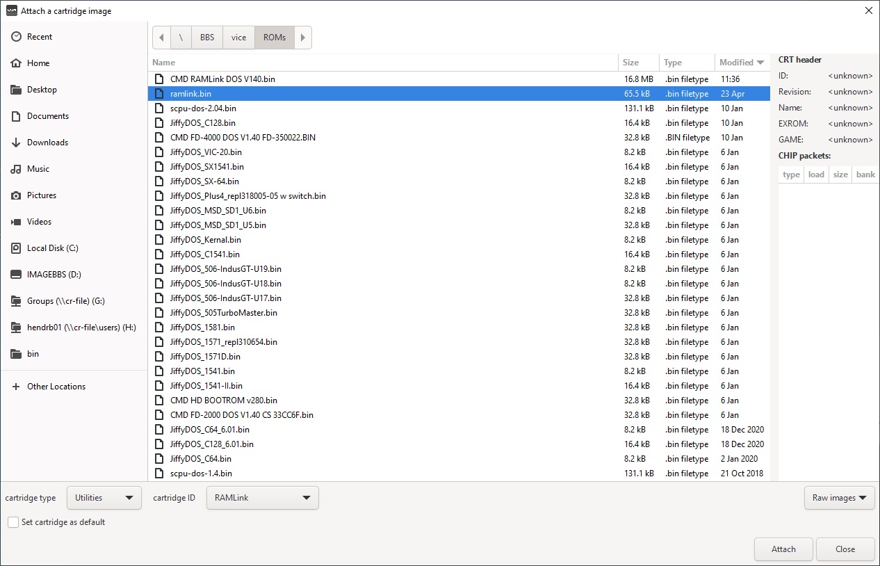

Next we will go ahead and attach the RAMLink cartridge image.
Attach cartridge.jpg (223.79 KiB) Viewed 44165 times
Go to File > Attach Cartridge Image.
In the lower left hand corner select cartridge type Utilities - cartridge ID RAMLink.
Select the RAMLink ROM file. ramlink.bin.
If you want the cartridge to be attached when VICE is started, click Set cartridge as default.
Click Attach.

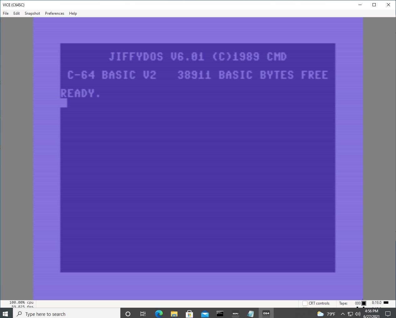

The emulated C= 64 should now restart and if everything is working, you will see the following screen.
RAMLink startup screen.jpg (228.43 KiB) Viewed 44165 times

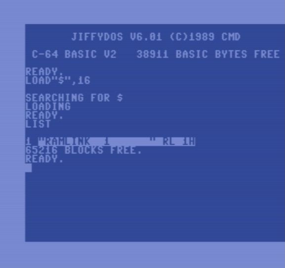

You should now be able to perform a directory on the RAMDisk (Default device 16).
RAMLink Directory.jpg (75.22 KiB) Viewed 44165 times
