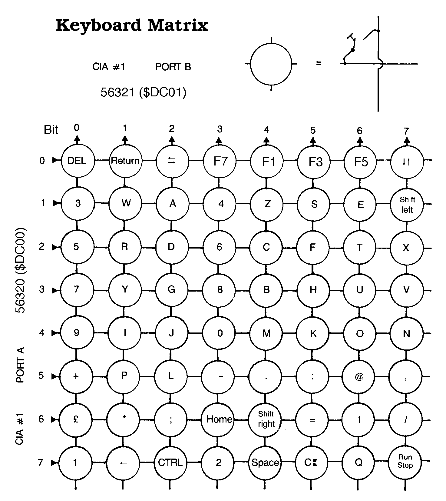

I also noticed as I watched the keycodes fly by while typing that I often would down the next key before I had upped the last key. I started to wonder if this may have been part of the problem the '64 was encountering, because over time I have noticed that certain keys seem to get missed with more frequency than others: the 'e' of the word "the", for example, often gets missed. Looking at the CIA key map for the C64 (borrowed from here: https://ist.uwaterloo.ca/~schepers/MJK/ ... matrix.gif)
'T' and 'E' both share the same data line on Port B.
