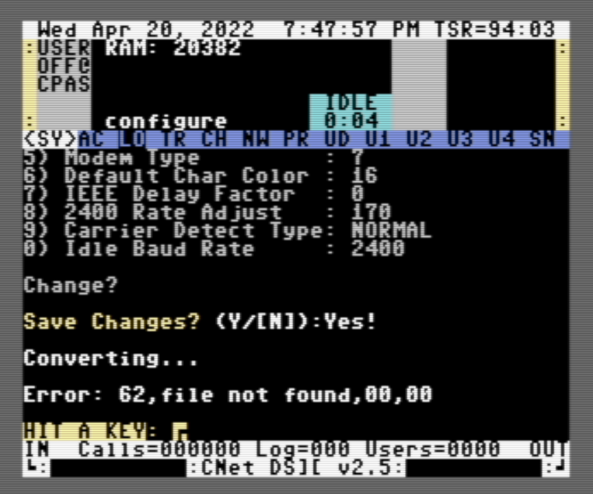

I've got my CMD hard drive set up, but I am having some strange behavior from DS2. This is stock, and I copied both disks into the same partition of the CMD. However, no matter what I have tried, when I try to set/change default parameters (Option 3 from the configure menu) I can make the changes, but it throws a File Not Found error when I try to save the changes. I don't know what file it is trying to modify here, but whatever it is - I don't have it. It also seems like whatever it is looking for, which is not there, also makes the board enter the configure program every time I boot, even though Users, access levels, subs, UDs, etc. are all configured.

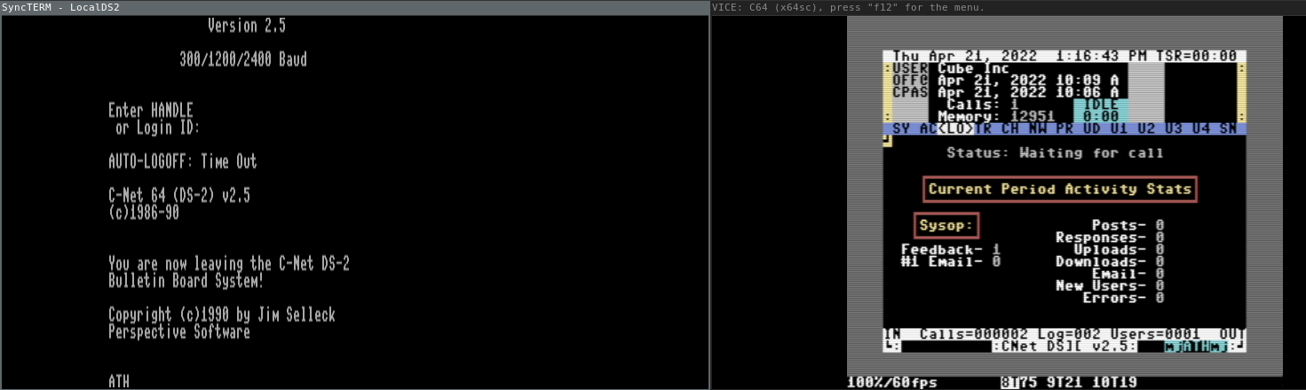

That is exactly what is happening, I opened up the modem files and followed the code around, and in HB's cn file he helpfully commented several lines where he is trying to drop the DTR pin right before calling the hangup (ath) command. Even though I have the appropriate device set to use the ip232 protocol which should transmit the modem status line over the socket to tcpser, I do not see tcpser ever reporting that any of the pins are changing. Still digging...
Re: C-Net 64 DS2
Here is what I have learned / figured out so far, and if anyone can correct items I may have wrong or can fill in more details on any of this, please feel free to do so.
I have figured out the DCD / DTR issues and it was partly my own misunderstanding of the way Vice works and partly a bug in tcpser (at least in how it operates under Linux). As it turns out, like many things, it's actually pretty simple when you know how it's done. On real hardware, DS2's swiftlink drivers rely on the modem status lines (or pins) to inform it when a connection has been established and when the other side of the connection has disconnected (IE: Hung up.) For this, it uses the DCD line, or Carrier Detect. Since we are not using physical hardware in this case, both the C64 and the modem are pieces of software, and the telephone line is the packet-switch Internet which, of course, has no Carrier Detect lines.
To overcome this architectural different, enter ip232. This protocol "listens" to the bytes that are being sent through the emulated phone line from one modem to another, and any time one modem needs to let the other modem know that one of it's signal lines has changed, it sends an 0xff byte (255 in decimal) followed by another byte indicating the new status flags. If the caller meant to send an actual 0xff byte, the ip232 protocol simply sends 0xff as the status byte and this is interpreted on the receiving end as a literal 0xff so that the in-band data does not get corrupt. Interestingly, if tcpser is not handling these status bytes correctly, they will show up as garbage in the stream, usually the little checkerboard character. Watch for this the next time you connect to a BBS - if you see a little checkerboard character when you first connect, that is Vice trying to tell tcpser that its DTR pin has gone high, (Terminal Ready) and tcpser has missed this byte and passed it along inband to the other end (hence the bug in tcpser).
The part of all this that I did not understand was that in order for Vice to engage its ip232 protocol, it needs to be configured for RS232 Network mode. Every version of Vice I've ever used and most of the tutorials I've seen on the matter show you configuring the rs232 device as "|nc hostname port" - What this does is it pipes the outgoing data through the Swiss Army knife tool Netcat (nc) to host hostname on port port. This works, but when running like this, Vice (at least the version I tested, 3.6.1) does not include any of the ip232 data - even if you've checked the box saying that this device uses that protocol. Instead, what you have to do is leave netcat out of it and simply put in the ip address or hostname, a colon and the port number as the "device", like this: localhost:25232 Now, Vice uses an entirely different set of code internally for communicating with the device, and it does include the ip232 signalling bytes.

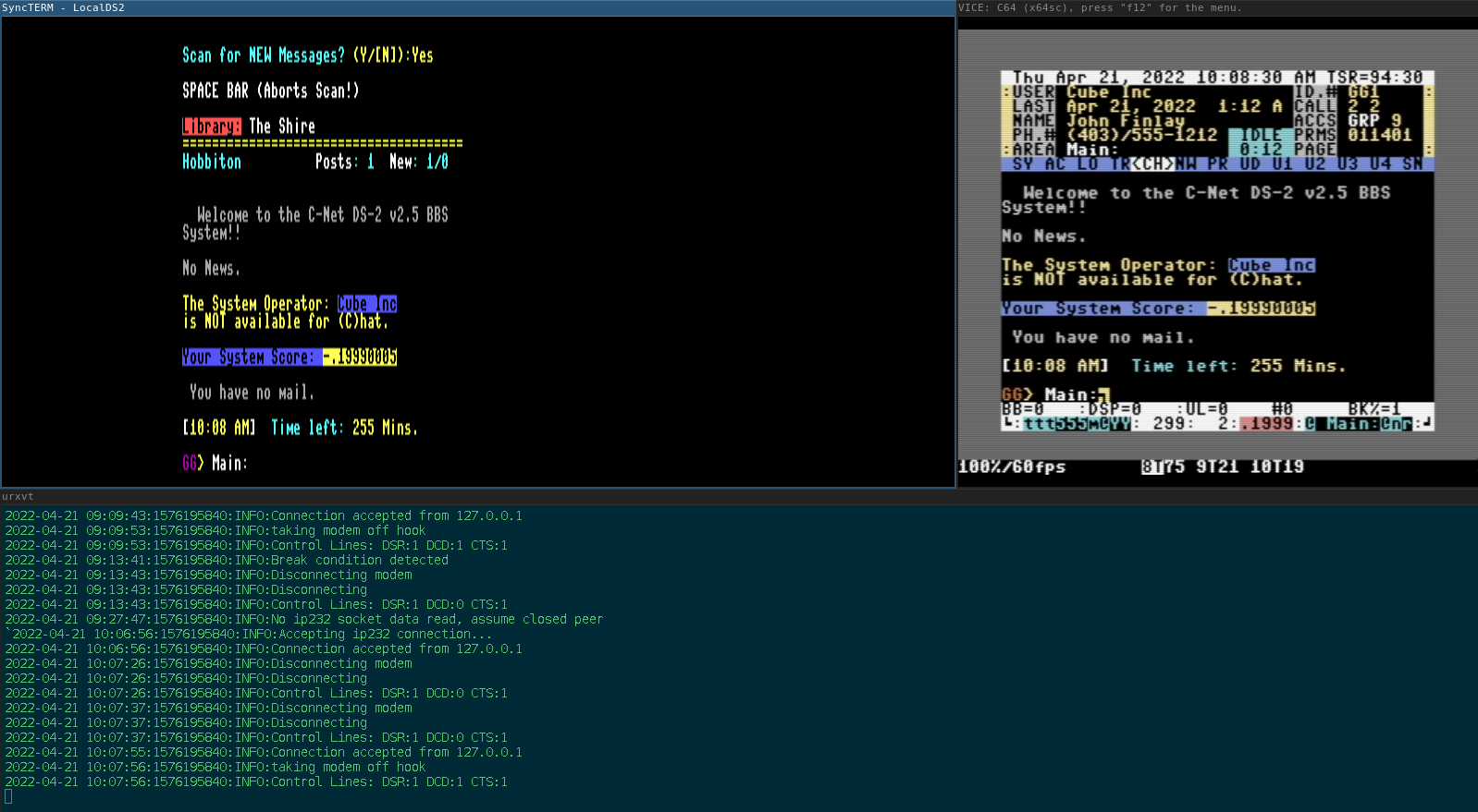

I found and fixed a bug in Vice, and now it will reconnect to tcpser automatically, instantly (well, as soon as tcpser is available again), AND without having to make any changes to DS2 or any other C64 program for that matter! What I've been doing to test is to start tcpser, fire up DS2 and wait till it gets to the Waiting for Call screen, and then restarting tcpser and trying to call the board through tcpser. By adding a whole bunch of debugging output to Vice I was able to track down exactly what is happening, because it detects the loss of connection to tcpser immediately but was not automatically reconnecting to it. In fact, after a dozen or so instantaneous attempts to retry the connection, vice would claim that "127.0.0.1:25232" was not a valid IP address, and would then open it up as a file and started directing all modem output to a file called "127.0.0.1:25232"!
Long story short, there's a function in Vice's src/rs232drv/rs232.c file called rs232_is_physical_device() which attempts to determine whether or not you've got a "real" serial port or a virtual one. It does so by attempting to allocate a vice_network_socket_address_t with vice_network_address_generate(). If this succeeds, the modem must be a network device and if it fails, then it must be a physical device - but this function never frees this socket allocation. Eventually, Vice runs out of sockets to hand out from it's memory pool, which is why eventually it gives the misleading (and quite incorrect) error message about 127.0.0.1:25232 not being in the correct format for an ip address and port. To fix, simply add the missing call to vice_network_address_close(). Here is the complete (fixed) version of the function, along with some of my comments and debugging code (commented out):

My two cents looking from your Screen shot, it that for some reason the Config program was running a conversion routine, and since you were setting up the BBS from scratch the input/source file was not present, hence the "File Not Found" error.

I looked around that web site and it seemed to be entirely centered around C-Net Amiga. Is there a secret knot I need to find in order to locate the 64/128 C-Net information / files? I found this page: https://www.cnet64.com/software-area/ which looked like exactly what I was looking for, but unfortunately none of the "links" on that page are links at all; all appear to be mere text.
As for being unable to enter local mode, I found that if I disconnected tcpser and set the "Invert DTR line" parameter in Vice, I can enter local mode just fine. I'm just not sure if it needs to think DTR is high or low for local mode to work though... It just needs to be the opposite of whatever the default, non-connected DTR value is. I continue to plug away at it...
