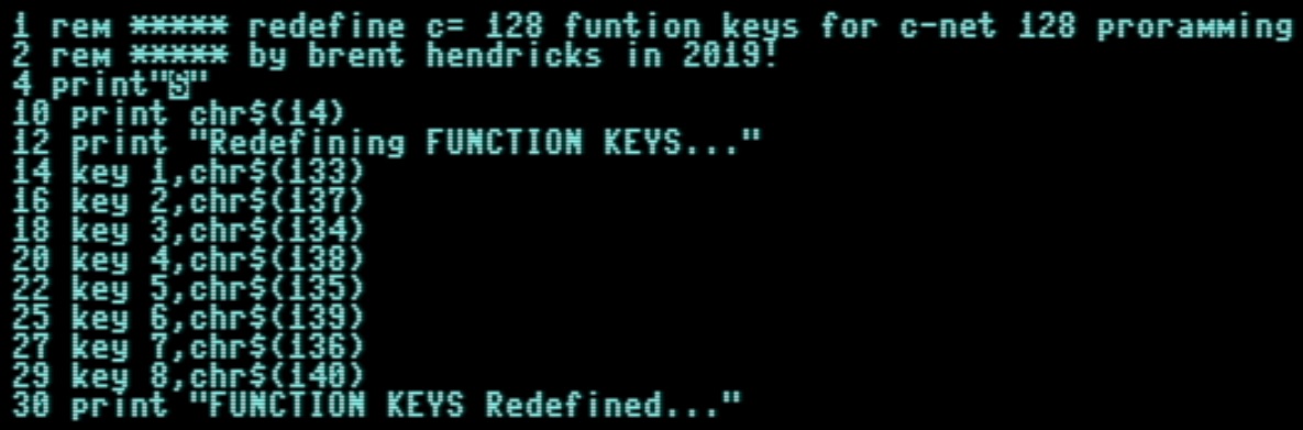

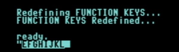

So I wrote a quick BASIC 7.0 program to do this!
C-Net Example.jpg (44.21 KiB) Viewed 21029 times
So, there is my first BASIC program written in about 25 years!
