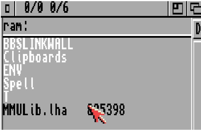

You can bring up both of these directories however you like, I have the path where the MMULib archive is present on the left, and the destination (RAM:) on the right.
- Click on MMULib.lha on the left and then click Copy. You will see i placed in our temporary working directory (RAM:)

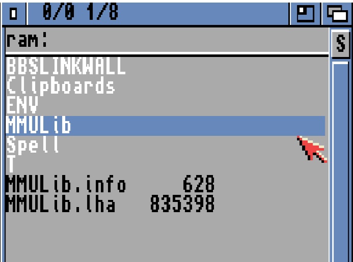

- Double Click on the MMULib.lha fil on the left hand side. It will automatically decompress if you have LHA present in your C: directory.

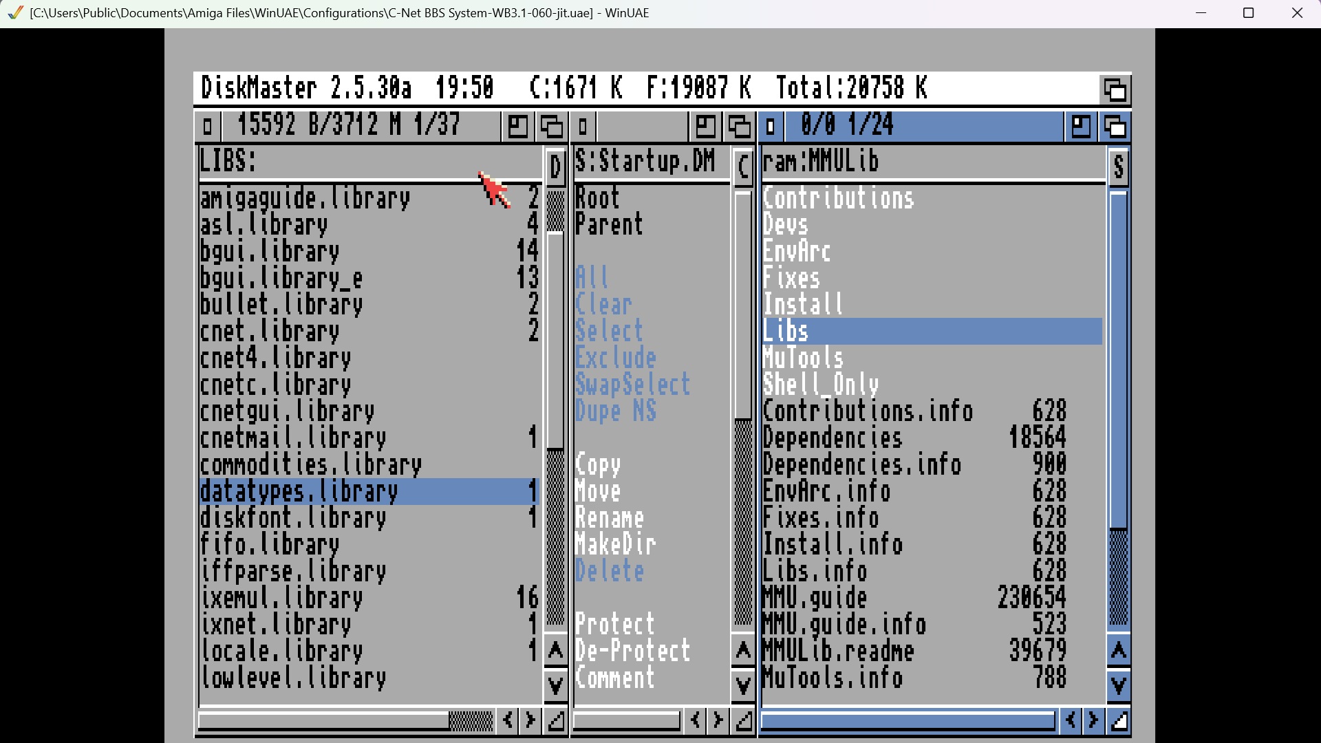

- Now, double click the MMULib directory on the right hand side (RAM:) and locate the Libs directory.

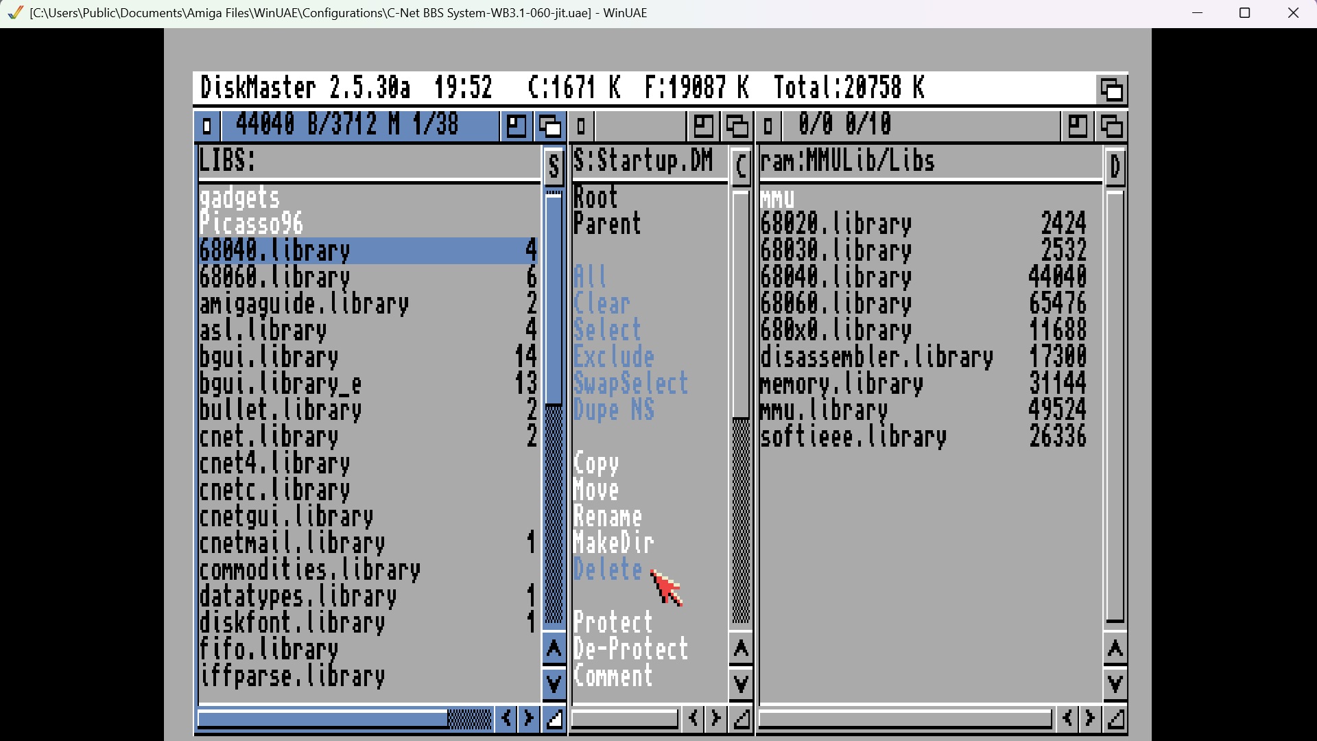

- Now on the left hand side navigate back to the Root of your Hard Drive, or type LIBS: in the path window.
- On the right hand side click on 68060.library and click copy.
*** At this point backup any 680x0.library file that may be present in your LIBS: directory. The easiest way to do this, on the right hand side either type in the name of your main Hard Drive (DH0:), or navigate back to the Root level. Click MakeDir in the center and name the new directory anything you want (Libraries-OLD). Now select the 680x0.library file you wish to backup on the left and click Move.
You should now be left with only the 68060.library in your Libs: directory.

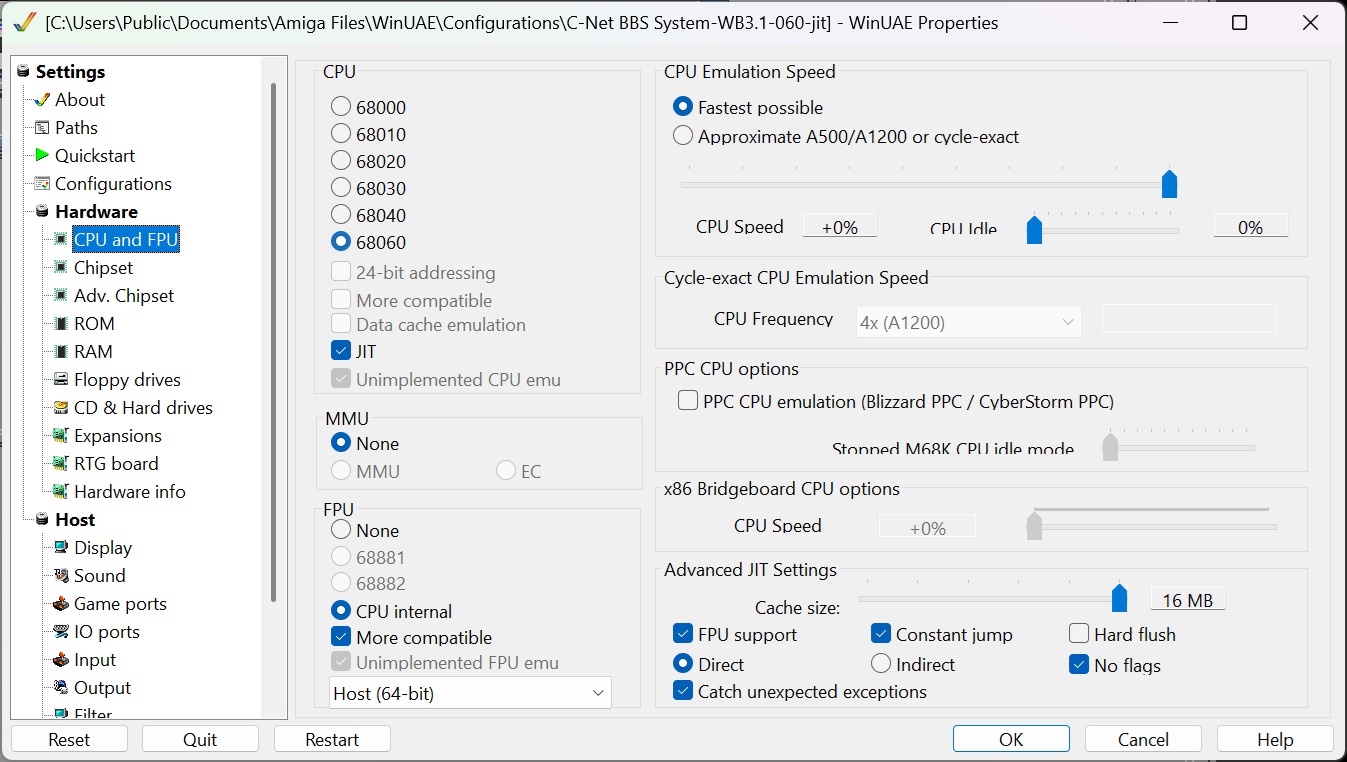

- Press f-12 to go to the WinUAE configuration screen.
- Select CPU Settings on the left and set your configuration to match this screenshot.
* NOTE: The MMULib documentation states you must have an MMU present (The 68060 has an internal MMU, which is why I am chancing enabling JIT in this example. So far so good. Use at your own risk!)
- Test the configuration by clicking on the Reset button (NOT Restart) on the bottom of the WinAUE screen.

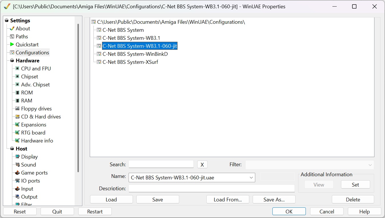

Once you are happy everything is functioning normally, you can save the new configuration settings.
- Press F-12 Again and select Configurations on the left and resave the configuration file as anything you want.
