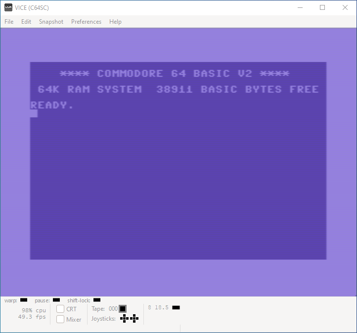

Actually, this time when I tried asking for help in the console (x64sc --help), it returned the entire help menu as it should! That means that the binary is working! Let me see if I can build a dist zip - I probably need to install the roms and all that. It may not be running because it can't find any of the ROM files.
Ok, so it looks like it built a zip file that appears to be sane; I extracted the contents and tried to run x64sc.exe from there and it is complaining about missing .dll files now, specifically libatk-1.0-0.dll. Something is still not quite right, but it is getting closer!
